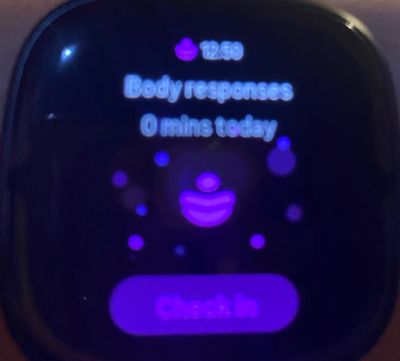

Im having the same problem with support aswell, couldn't do a 24 hour text support because apparently they were busy so I contacted them on twitter to no help then finally got into text support which the text convo went on for 2 hours with no resolve they said they would email me later im pretty sure i was talking to ai for 2 hours
With enough re-syncing and turning off and on body responses in the stress management setting i get this picture above but once i swipe to the next tile and swipe back it goes back to the same thing

Does anyone actually have this working?
I've gone through the setup like 50 times now, cleared the app cache, reset the watch and the phone, uninstalled and reinstalled the Fitbit app, uninstalled and reinstalled the tile and watch apps, factory reset and re-paired the watch... and it STILL just displays the "To get started, open the Fitbit Mobile app on your phone" message every time I check that tile. Occasionally when I try to check that score on the phone, it'll show me the score, but it will make me go through the setup AGAIN as well.

Hi everyone, and welcome to our new members.
Thanks for the steps you've tried, and the pictures provided. I'm sorry you've had these difficulties with your watch. So I can look into this, may I know since when this started to happen? Have you tried removing and adding this tile again? Could you go to the Fitbit app, tap your profile picture > Sense 2 and verify if the firmware version 194.61 was fully installed?
In the meantime, let me recommend these other steps to reconnect your watch to the Fitbit app:
Once that is done, go to the Fitbit app, tap the Stress Management tile > Gear icon at the upper right corner and make sure Body Responses are turned on.
