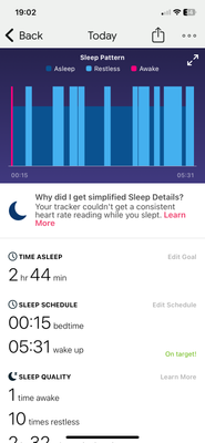

My Sense 2 started giving a simplified sleep score two nights ago, I’ve not changed wrist or adjusted the strap, the app is up to date and i am getting more thsn the minimum sleep. Please advise

Best AnswerHi there - its saying that its unable to detect a stable heart rate and then marking about half of the time as “restless” - so a sox/seven hour sleep came up last night as 2 hours 44 (I slept well) photo attached
