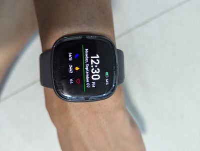

I have a Fitbit Sense 2.
For the past six hours or so, Fitbit is showing Greenwich Mean Time (GMT) on my Fitbit.
I live in India, which is GMT+ 5 hours and 30 minutes. I went to Settings on my Fitbit app on my iPhone and checked "DATE & TIME". It shows Location: India; Time Zone: Asia/Kolkata. Both of these are as they should be.
I then clicked Time Zone and it said the 'Set Automatically From your phone' option is 'on', And my iPhone shows the correct Indian Standard Time (IST) which is GMT+ 5 hours and 30 minutes.
How do I get the Fitbit to show IST and not GMT.

I am in India and I have same problem. It is 7: 13 pm in India but my Sense 2 show 1:43. I sync multiple times but it shows wrong time

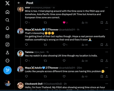

Is trending on twitter so hopefully they will fix it soon!
