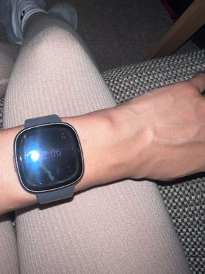

I’ve reset it as suggested and I always wear it one finger below my wrist but I’ve added a picture to double check. It’s still seems sensitive.

It's good to see you around, @Missdjcandy.
You're welcome! Thank you for the additional information and the picture provided. I understand your concern and how this affects your overall goals. Since you've already tried the suggestions shared above, please keep an eye on its behavior to see how it goes in the next few days.
