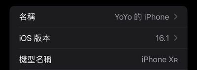

This is my OS version. And I have iOS 16.1.

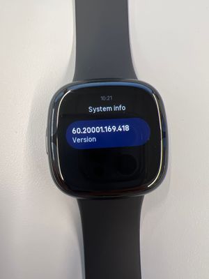

Noticed there is Sense 2 Firmware update this morning. Hope it resolves this.
