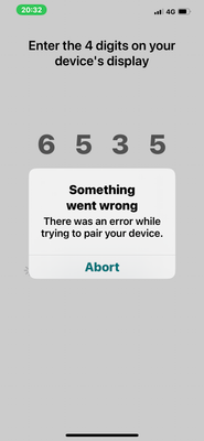

Hi, my Sense 2 does not sync with my iPhone for 2 month, time of wrong by 3 minutes (which is ridiculous). I tried to all steps, forget device, remove from app. It stopped pairing- when i get message with 4 numbers to pair, after some 5-7 minutes of trying to pair the phone show message”something went wrong” and watch continues to live its own life.
is it something wrong with hardware? Do i need to replace the watch?

Thank you, but nothing works. I reinstalled application, removed device and got the same message …

Thanks for getting back to us and for providing a picture of the message you get @HudsonSherlock.
Please try pairing your Sense 2 with a different device.
