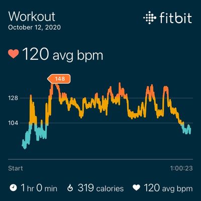

Guys, my Sense was the same, I was going to have to return it tomorrow, that’s when my 15 days was up! However, I restarted it, and it’s working FANTASTIC now! I’ll attach a pic if I can, then another of the exact same workout last Thursday, when I gave up on my Sense and put my Versa back on. Since I wanted to give it every possible chance, and return window closes tomorrow, I reinstalled the Sense to my account, and Restarted the watch. It is now more accurate than my Versa, and my Versa was DEAD ON.
Restart it, and try a workout! Good luck!

This is the EXACT same workout last Thursday, before I restarted it.
Try it, you’ve nothing to lose, and everything to gain. 🙂

The Restart fixed mine! How about you? I posted screenshots of my two identical workouts and the crazy difference between before I restarted it and how accurate it is now. Try it! 😎
