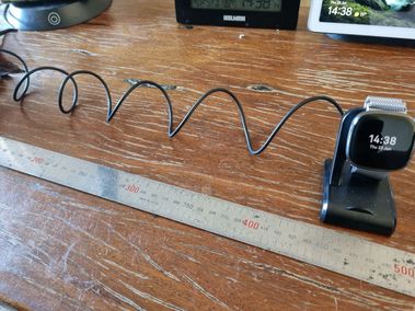

The third party one finally arrived yesterday (I have a love-hate relationship with Australia Post, mostly hate - things don't arrive forever, then magically appear in my mailbox less than 24 hours after lodging a query). On the first connection, I automatically went to shift it around to align the pins with the holes as always until I heard the pins make contact, but.... they were already connected. It seems as though this one somehow aligns itself better than the OEM. It also has a longer cable and the stand can have it facing me if I need to see the time. Next is to test the longevity, but will order another in the meantime. I think it was AUD 5.94, so not a big deal. The band was also bought for a few dollars online. Metal band with a magnetic clasp that has been a lot more comfortable than the Fitbit ones.

Thanks for the photo and info @Ftumch - can you post the link to this charger.
The one I got was here (click photo) for about $3 and is still working too, seems more robust.
To ensure proper alignment haven't yet found one with a clip like the original Versa chargers to see if that is even better and eliminates slow charging totally.
