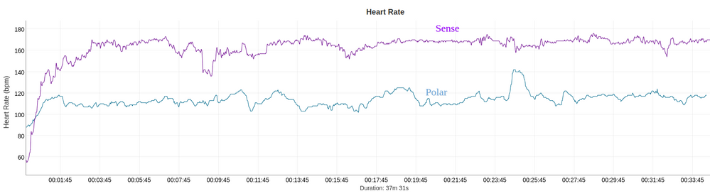

I had the opportunity to try the Sense and found the HR sensor completely off, both during normal day tracking (with AZM increasing while watching TV for example) and during my runs.
Below is the comparison between my Polar Vantage V (associated with H10 chest sensor) and Sense. The run was an easy session hence the Sense values are completely wrong ('m a 50 year old man with max HR around 170)

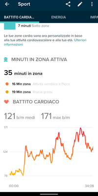

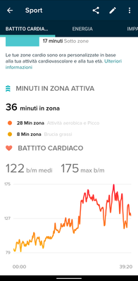

I don't have big issues with my HIIT workouts.
Just 2 examples from few days ago
3 possibilities in my opinion:
1)watch too loose
2)looking at the rest heart graph where spikes are not shown
3)real issue with the watch and it would be better to consider a replacement?

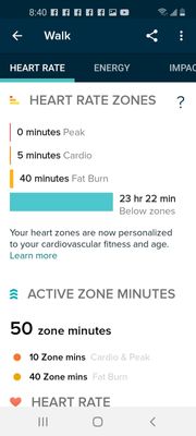

My issue is it hits 137 while I'm doing hard work chores on the "walk"
exercise mode, but day-long HR never reaches above 113. Also the exercise
numbers don't match - see attached. (I was testing the exercise mode so had it on overnight.) I'm trying to see if it can capture arrhythmia while sleeping. It may not work for that but it doesn't seem too dependable on the whole...

Update. Watch face on exercise mode said max hr was 141 for last tracking session. Fitbit app on cell phone (attached) says max rate isn't even in the fat burn or cardio or peak rates even while showing 6 and 5 minutes in those zones. Also graph shows no higher than 79 bmp. I did not do much yesterday, my ♡ app says max is 96 which is usually 15 beats lower than the exercise app records. So I think this watch is breaking down?
