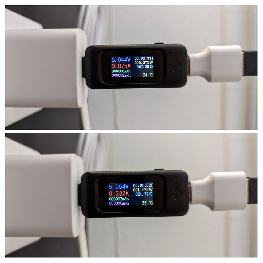

@loko123 Welcome to the Fitbit community.
A couple common issues is the charger is either physically damaged (pins are stuck down or missing) or the connection isn't good. The second one is an easy fix. I just wipe the pins (clean way is with an alcohol wipe, dirty way is saliva on a finger) and it get it fast charging.
Top pic wasn't wiped. Bottom pic was. You can see the difference in the Watts and the Amps

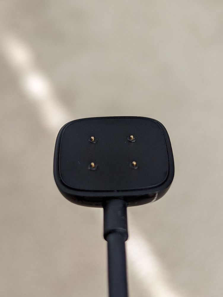

This is a pic of my charger pins which are all clean and up.
