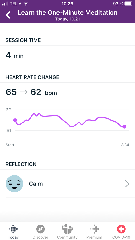

Hi LizzyFitbit
Thank you for helping out.
After manual sync and opening log of the mindfullness session
After 5 sec, a fragment of the measure HR becomes visible
After completing Mindfullness session. No heart rate shown

Hi @LizzyFitbit Thank you for following up on this issue. It is the same, the session still show no hearth rate available until you go back and sync the device.
I have tried twice, both with and without EDA scan on the new 3.33 app version recently released.
It only show a partial result if I do it quickly, jump out to the main screen after a mindfull session, press sync, and go back into the log. One more sync is needed to get the complete graph populate with HR data. As the HR wrist monitor usually is a handfull of seconds behind, I assume it need at least 5-10 sec before it has the complete data set ready to match the period of the session, and it never would be able to show the result right after finishing the session.
