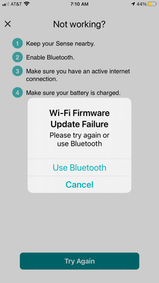

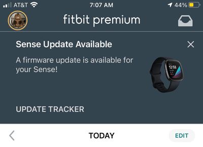

Just got my banner to update to 44.128.5.38 from
44.128.4.17. Updated without issue and everything seems good.
If issues with data over next 24 hrs, I’ll report back.
Below is the banner I saw at the top of my app when accessed. It showed up around 7 a.m.
I had been in the app several hours prior.
I did have to use Bluetooth to download. For some reason wifi did not work, so I selected Bluetooth and it proceeded without issue.
