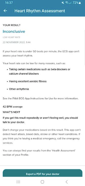

@Guy_ ECG does work below 50bpm but the report is inconclusive:
All it means is that when HR goes below 50bpm the algorithm cannot detect Afib. I always get "inconclusive" (in this example my average HR was 42bpm but it's not my all-time lowest so there is no chance for me for anything else but "inconclusive").
@SurreyUser you seem to be mixing up two things. There are two independent sensors to track your HR. ECG uses electrodes on the side of the device and all-day HR uses green LEDs at the bottom. There is no connection between them. The ECG sensor runs only when you use the ECG app and PPG (green LEDs) do not contribute.
