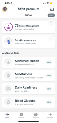

Go to today page
top right click edit  (you then have the ability to add or delete tiles.
You should see a daily readiness tile. Click on the “X” and it deletes and moves it to the bottom of the page.
if you want to add any back just click on the “add” next to that tile.
You can also hold your finger on a tile and it will activate so you can move them around and position them in the order you like.
You can see below that my readiness score tile is not active.
I
