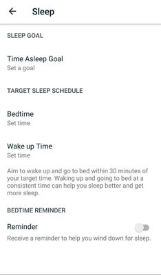

@eezeepee Thanks for your help. For snore and noise detection, I followed the steps but there wasn't "Detect Snoring" option there:
And about SpO2, it wasn't installed at all.

@eezeepee There aren't further options to scroll! That's all I have on that page.

@Shapour, what version of the Fitbit app are you on (under Help & Support)? The option is showing for me running 3.54.1.
You can also try doing a factory reset on the Sense. I had the same battery draining issue and a factory reset cured it for me.
