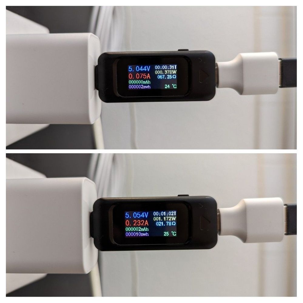

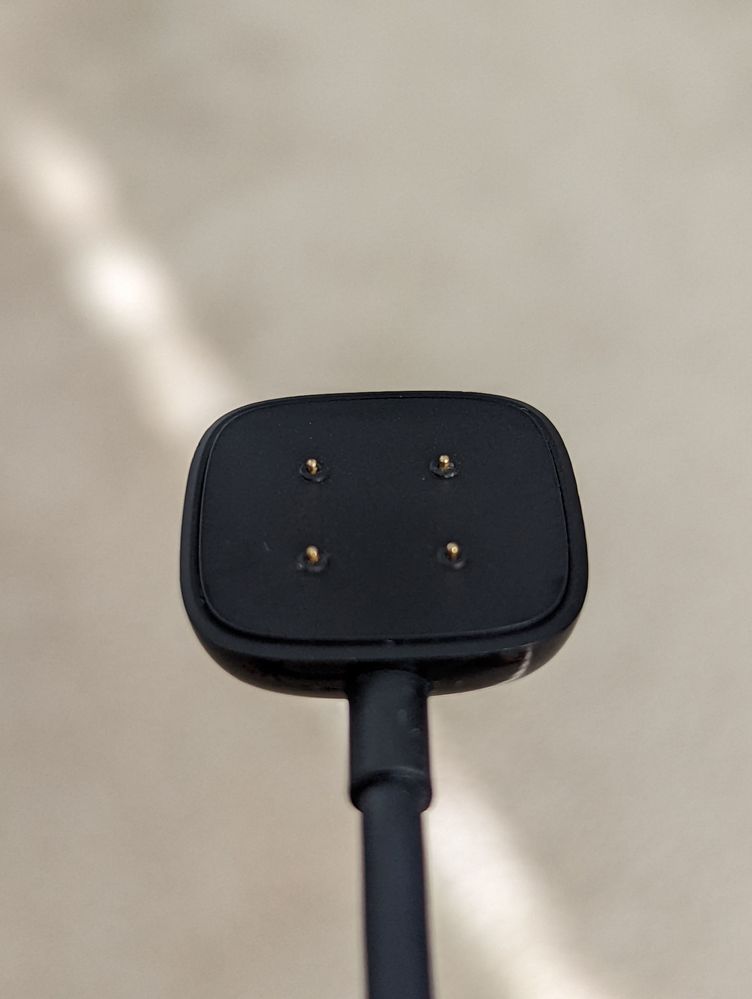

@Hax_Siao @Mignon72 It's possible it's not the Sense and just the charger. A lot of times it's a connection issue that is either a hardware failure on the charger pins or just a poor connection that's fixed with a wipe of the pins with something like an alcohol wipe.
The pins should be clean and up like above.
Top pic is a poor connection bottom pic is a good connection. Notice the difference in amps and watts. With the good connection I can get around 2.2% per minute of fast charging.

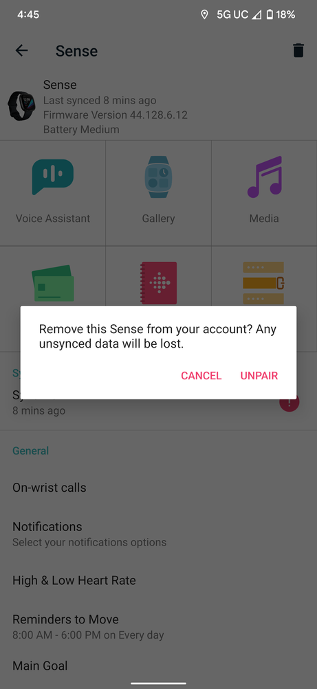

@Mignon72 I just reread your original post and missed the part about being unable to deactivate your Sense.
You can't just go to the Fitbit app, tap your account in the top left corner, tap Sense, and then delete in the top right?
