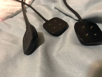

Is it just me or are the chargers for the Fitbit Sense faulty?! I have owned my Sense since Christmas Day 2021, in which within the last month my original chargers has stopped working. I bought a 2-pack of chargers off of Amazon, and as of this morning (2 days after my birthday) the replacement chargers no longer work as well! Yet again, I am going to have to buy chargers off of Amazon to be able to charge my Sense! Maybe it’s just me, though it would be greatly appreciated if Fitbit could manufacture good working chargers period!
Best Answer03-14-2022 20:51
03-14-2022 20:51
I have included a picture of how my 3 chargers :electric_plug: look like! After having owned my Sense Christmas Day 2021, the chargers should be working just fine. However, since this is the second time this has happened to me within the last month now, once again I am having to turn to buying even more chargers from Amazon…

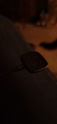

They definitely have a connection issue which, for me, can be fixed easily. The top pic is when the connection is poor, says Slow charging,and the meter says 0.075A and 0.378W.
The bottom is when I wipe the 4 prongs on the charger (clean way with an alcohol wipe, dirty way with a finger and saliva) and you can see the improved amps and watts. At that time I went from 18% to 60% I'm about 20 minutes.
This charger is the original received with my Sense which was ordered on August 2020.
