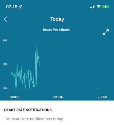

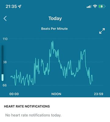

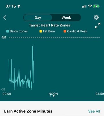

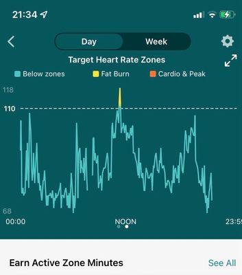

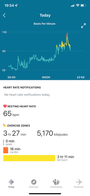

I have observed the same behaviour with the graphs as well.  There also appears to be a trigger point that must be reached before it happens.  Also seems to, in my case, affect the portion of the graph between midnight and 2am approximately.  The section seems to triple in scale.
I will try to attach the photos of the graphs, however I cannot find the area referred to in the message link above on my iphone.  I may need to go to a real computer
 heart rate and zone minutes graph in sync
 heart rate and zone minutes graphs out of sync.   Most aparrent in the midnight to 2 am area.
 Ok last set.  Additional error i have noted is the presence of zone minutes in the graph that don’t exist in the data further down.  This set is the most pronounced in the error.

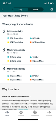

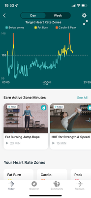

For an activity today, my maximum heart rate within the 'Active Zone Minutes' module was 142, within the 'Exercise' module it was 150, and within the 'Heart Rate' module it was 138.
3 different maximum values given for the same period of time doesn't instill confidence in the accuracy of my Sense!

I stumbled across this while trying to figure out what was going on with my own charts. The simplest explanation I can give is that the graph for ”zone minutes” is just more accurate than the “today” graph. The zone minutes are tracked every minute but the numbers shown on “today” are the average of 5 minutes. Meaning the heart rate only spiked up for a minute at most (probably snoring based on everything I’ve read). Hope this helps!
It doesn’t explain the zone minutes graph shifting from the a.m. results to a different p.m graph with the same data.  See the midnight to 3 a.m. area shift from the morning graph to the evening graph.  Also the zone minutes showing on the graph that don’t exist in the zone minutes data.  There is a problem in the way the graph routine is processing the info to create the graph.

Thanks for the details and screenshots provided. I'm sorry the heart rate, exercise and Active Minutes Zone graphs show different heart rate readings and appreciate your efforts on this matter. Given this situation, may I know the model and OS version of your phone? Also, do you recall since when this started to happen? These details will help me to further investigate.

I tried the process you gave and no change to older graphs.  It has been making the errors for at least the last few updates, however I can’t remember when it started.  I would presume it started at least as far back as the original poster for this question.  I added in my pictures when I found the posting as the inquiry seemed to have gotten lost.
Hopefully I can generate a graph tomorrow to test for the error just in case the process did accomplish something, but the phone has gone through a few restarts post updates of iOS so I expect that did the same thing.  I usually don’t have the Fitbit app running continuously though.
Well looks like no change.  By about 12:30 the zone minutes graph started to show the error.  At 5 and at about 9:30 things appeared ok.
