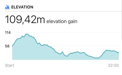

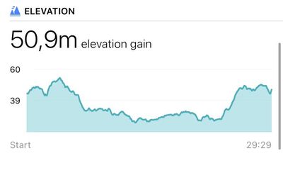

Yay, I think i found the problem, or at least the cause of my extremely high number of floors and fixed it.
I cleaned the sensor, it mist have been clogged with dust and dead skin cells. Rinsed it under a flow of luke warm wather. Read this trick for similiar issues with the garmin altitude readings.
From last year: pretty accurate view
Same route as above, the last month
and
And now, watch this after first attempt at cleaning the sensor. It also stopped logging huge number of floors while walking around outside
I noticed the pressure reding in the elevation app was way off at times, today it read 999 hpa instaed of the correct ~1016 here this morning.
After rinsing the sensor it read out 1016 and was rock solid unlike earlier where at was drifting up and down.
