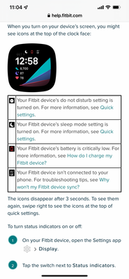

I did the update on my sense today. Every since I have been seeing a rectangle with a line through it on my home screen on my watch. Sometimes it stays for a few seconds and goes away, sometimes it flashes on and off. My watch seems to be working okay, but I've never seen this before. Can someone provide an explanation or a fix?

It means that your watch is not connected to your phone

Hi there, @Jkenn43. Welcome to the Community Forums. Thanks for the details provided in your post about the issue with your Sense. I understand where your concern is coming from,
If this happed after the update, it could be what @nicoscy has mentioned. Did you already sync your Sense? Have you checked if your Sense is still linked to your Fitbit account? To make sure your watch has recently synced, go to your Fitbit account, tap the Today tab > your profile picture > your device image.
If by any chance you are running into syncing issues, see Why won't my Fitbit device sync?
Hope that helps.

You can turn off status symbols until sorted out.

See page 21 of your user manual for the meaning of the3 icons at the top of the screen.
@Cass_Peter remove the tracker from your phones Bluetooth. Clear the cache of the fitbit app.
Now start the app and hopefully the Sense will sync.
For more tips see https://help.fitbit.com/articles/en_US/Help_article/1866.htm?Highlight=Sync
Your phones Bluetooth should not be able to pair with the tracker.

@Cass_Peter would you be able to post a photo of this diamond. I can't find anything in the user manual and this thread is about the phone icon with a line through it.
Have you tried a restart by holding in the button?

Hello, people. The sign means DO NOT DISTURB and you can fix it by swiping to the right and the first button is the exact sign appearing on the home screen.
Deactivate de button and the connections will start function again - in my case it was active and the phone was not communicating with the fitbit anymore. You are welcome.
