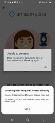

I am stumped 🙄 I've tried everything except for a factory reset. Cleared cache in Chrome, Fitbit and Alexa. Even re-installed the Fitbit app.
I still recieve:
"Unable to connect"
"There was an error connecting to your Amazon account. Please try again."
This is on the phone Fitbit app where you connect the account.
It's immediate after the tap so it does not seem like it's even trying.
The Alexa app, the Amazon app and everything else seems to work quite well.
I have a Note 8 and recieved my sense yesterday (latest firmware)
Thanks

The second Sense did the exact same thing. Eventually someone at Fitbit said that because I was running Beta Fitbit code on my phone as opposed to the actual release software that the Beta had issues and to revert to the release code so I did that. That allowed me to install Alexa on my sense. However, at some point Alexa has now disappeared on my Sense because when I long press the button it asks me if I want to set up an assistant again. So there is more work to do here for Fitbit for sure...

Make sure you aren't running the Beta code from Fitbit. In the Google Play store it should show you whether you signed up for the Fitbit Beta program or not, if you did, then get out of the Beta program if you want to get the regular "working" code as the Beta code doesn't work. I was in the Beta program for 2-3 years and never saw any benefit from it and this was a specific detriment.

Hey, I've just figured out how to do this. Uninstall your Amazon app from your phone then set up the Alexa bit on fitbit and then you can reinstall your Amazon app. Worked fine for me after that.

I was actually just going to come in and post this same thing. Mine kept saying there was a bug with the amazon shopping ap. Did yours keep saying that about the bug? Since it kept saying it about the bug that was when I was like Ah ha, wonder if i remove the ap. I did and it worked then i put the ap back on.

I had this issue, talked to Fitbit Support, etc., and couldn't get it to work. Today, I FINALLY got it to work! On my phone (mine is an Android), I went into the Amazon Shopping App, went to the "3-lines" menu on the bottom, and then Scrolled down to "Settings." Under settings, I went to "Not [My Name]? Sign Out". I clicked that and signed out of my account. I then logged back in. I then went back into the Fitbit app, set it up again, and it had no problems logging into my Amazon account and linking Alexa! I think it must somehow use that app on the phone for the login verification. I hope that helps!

Yay this worked, Uninstall Amazon app. then repair to fit bit, thanks!!!

I ended up logging out of Amazon Shopping App, then force stopping and uninstalling every Amazon App on my phone (Pixel 4) and tried to link again, it logged into the Amazon Website and logged me in fine. It definitely does not like the Amazon App. This is stupid.
