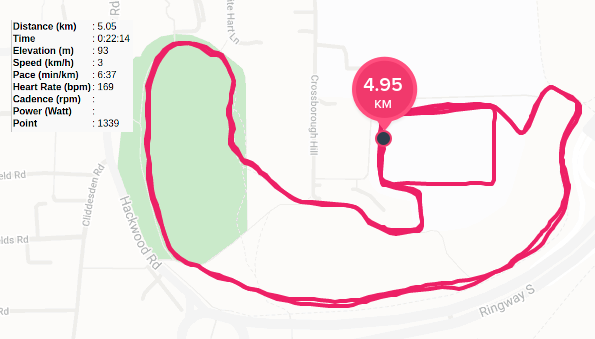

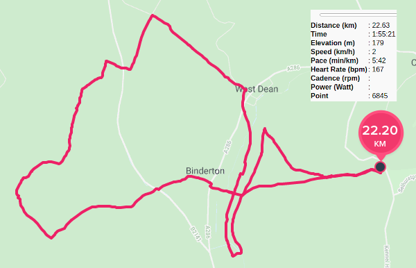

@wicks21 GPS is also used (afterwards) to adjust automatically stride length. I'm not sure whether it's still an issue but with my first Sense I had plenty of GPS related issues (not connecting, disconnecting, dropping accuracy) and bad GPS could affect the next run with bad distance (due to automatic stride miscalculation). However, at some point, those issues disappeared (I also got another Sense, maybe the previous watch wasn't working properly, I will never know) and the distance calculation is pretty accurate (and GPS works well, too).
If you track your activities with GPS, then from Dashboard export the TCX file and upload it to https://www.mygpsfiles.com/app/. See, what is the length of the actual GPS track. It will be different from Fitbit distance but you will know how much is off (also, see whether the GPS path has been tracked accurately).
See examples:
5k, distance short by 100m5k, distance short by 100m
Half-marathon (+a bit), distance short 430mHalf-marathon (+a bit), distance short 430m
The second case it's quite a long- istance and the difference is almost 0.5km (which makes difference to the pace). The first case isn't so bad (just 100m) but annoys me more because it cuts short the race distance but in general, it's an acceptable margin. Try to compare the GPS to Fitbit distance using the link I gave you and see the real difference (no point to compare Charge 4 and Sense if your point of reference is the GPS map).
See examples:
