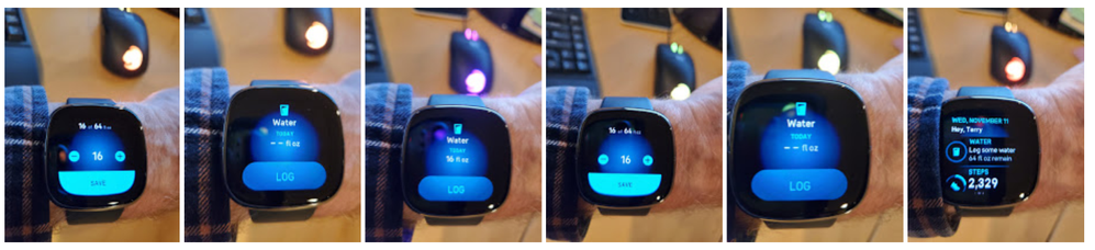

No - it simply does not work.
Here is an ordered sequence of what one might see:
Moving from left to right:
1. log 16, save
2. shows empty
3. come back, suddenly appears OK?
4. log 16 more
5 empty
6. screen says 64 oz remain
I'm running out of patience playing with it, and the answer equivalent of "try re-installing Windows" is no more satisfactory now than when it was first used 🙂
The engineers need to do some more real-world testing before you ask more of customers.

Hi @FitMe2020. It's good to see you again.
Thanks for the screenshots and details provided, as well for your efforts while troubleshooting the Fitbit app. Just to confirm, before you mentioned to have an Android device but in your recent post it says Windows, could you please confirm which device you're using? Even though the Fitbit app can be installed in a Windows device, please note that the Sense was optimized to work with Android and Apple devices. If you try to sync with a Windows device, your data may not update correctly in your account. I understand how you're feeling about having this issue and to make sure we've exhausted our steps, please give a try to the suggestions from my post on your Android device.
If by any chance the issue persists, please provide me with the model and OS/software of your phone so I can look into this.
