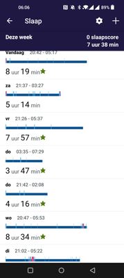

No A-fib but still a "Your tracker couldn't get a consistent heart-rate reading while you slept" message for the last 6 days. I have had sleep stages rather constantly since I have the Sense (over a year now). So it's very strange it just stopped working. Nothing changed, same wristband, no weight loss (or gain), no change in apps or watchface. You would almost think that Fitbit was tweaking 'the algorithm'.
Restarting and cleaning as suggested in the help section didn't work. So I'm open for other suggestions.

@RonaldM Wow that's really strange. Yet during the daytime you're getting your heart rate just fine right? You haven't done a factory reset?
Sidenote: You seem to sleep pretty well with no awake (pink) lines, unless that's because it didn't have your heart rate.

@eezeepee yes, first I tryed a reboot and then back to the factory defaults. But still nothing. I have my skin temp, oxygen and resting heart rate in my statistics. And it also measures my heart rate during the day and when exercising.

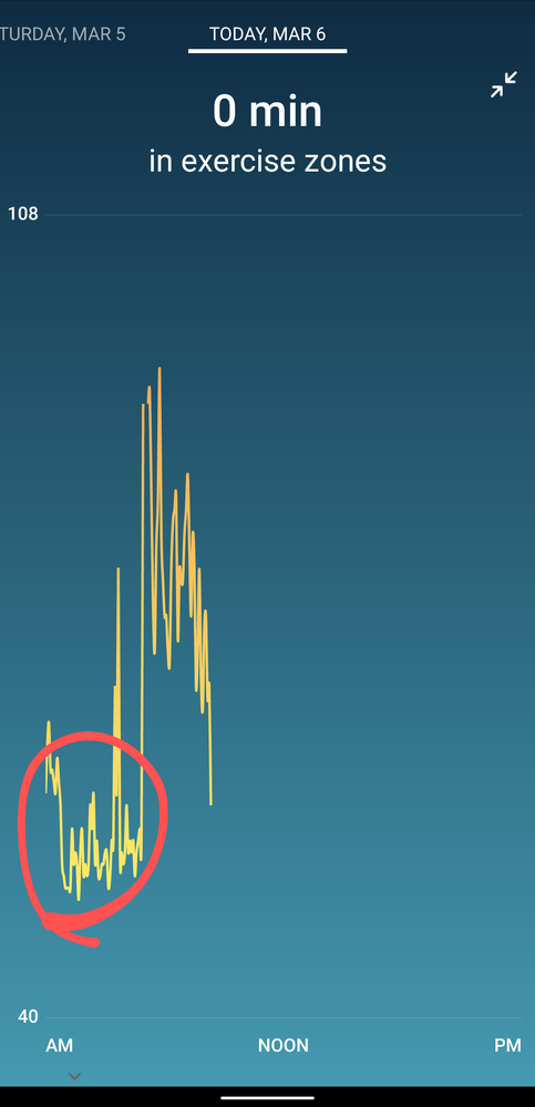

@RonaldM I think all the overnight tracking or first thing in the morning scores problems is a server side issue. This is just my theory and I don't think Fitbit has ever officially given it as a reason. It's pretty inconsistent when these issues happen and it doesn't seem to be a Fitbit device or phone syncing issue. Yesterday, I was actually missing March 4 and 5 SpO2 overnight numbers (It's the only health metrics that I seem to miss once in a while) and then this morning I have March 6 as well as the missing 4 and 5. For you to go that long without a proper sleep score because the heart rate was detected is very strange.
When you go to your actual hearth graph, do you see the night time heart rate though? I circled my sleeping heart rates in red.

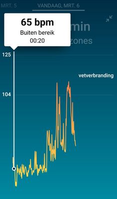

Same here, heart rate monitoring doesn't miss a beat at night...

@RonaldM Yeah that's why I'm leaning towards a server side issue. I hope you get your issue fixed.
