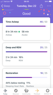

@olledejong   There are a lot of old posts available, despite the fact that they are completely irrelevant.  Your sleep score is based on three things: Time Asleep, Deep and REM sleep, and  Restoration (a component that looks at your sleeping heart rate and restlessness).  The Time Asleep, that component that uses the time in bed and time asleep, accounts for only 50% of your sleep score.

@olledejong   Those scores differ because two different things are being measured.  They will always be different.
Here is how Fitbit calculates a sleep score:
Cropped to fit.  Sleep score is 87.Cropped to fit. Sleep score is 87.

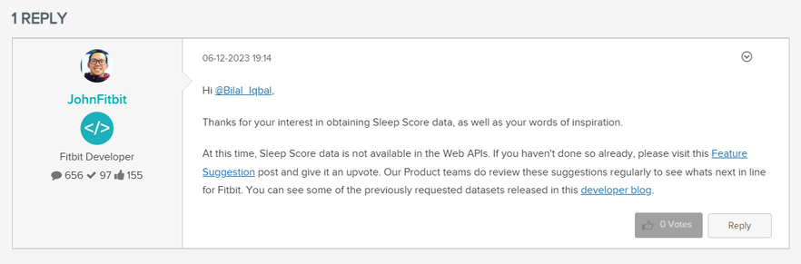

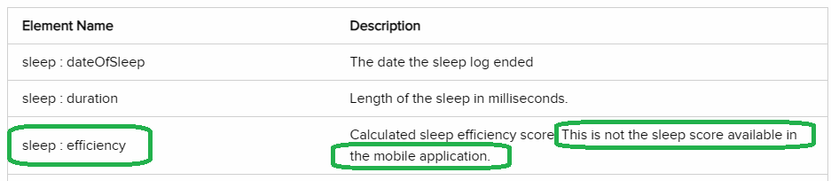

Any news regarding fitbit including "sleep score" in the API?
Thanks everyone. I'm looking for the same "Sleep Score" value which Fitbit state is different from Sleep Efficiency in the dev API docs [See 1st Image below] The API only provides Sleep Efficiency not Sleep Score. As olledejong correctly mentioned, the mobile app has a different Sleep Score value, from the API retrieval of the same session which provides a different "Sleep Efficiency" score. Fitbit has said publicly they acknowledge there is no access to the sleep score with the API, and its not in the roadmap of upcoming dev (last mention was 2023).
