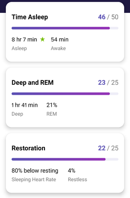

@gymaddict20 : incidentally, my best sleep score so far is also 91. Since you were asking about the breakdown, here it is (for my own sleep rated 91, your breakdown is likely different):
"Time asleep" accounts for 50% of the total, the remaining 50% being evenly split between " Deep and REM" and "Restoration". 46 + 23 + 22 = 91.
To answer your question about reaching a score of 100: very unlikely IMO. You would have to score 50/50 on "Time asleep" and 25/25 on "Deep and REM" and 25/25 on "Restoration". I’ve never reached the maximum on even a single component. Getting 25/25 on restoration would probably require sleeping HR to be nearly 100% below RHR and hardly any restlessness. I think the best I’ve had on restoration is 23/25.

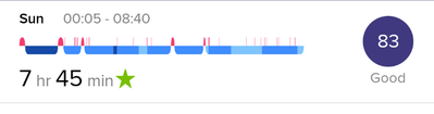

@adebaser wrote:I managed to get a new record low sleep score - by sleeping for 10 hours.
The score is not directly proportional to time asleep. Here is an illustration of this. Here, I slept for 7h45m and got a score of 83:
Here, I slept for 6h39m (i.e. more than one hour less), yet I got a slightly higher score of 84:

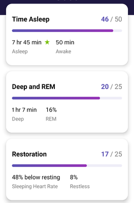

Why is that? Well, the explanation is found in the breakdown. This is the breakdown of the longer sleep rated 83:
Here is the breakdown of the shorter sleep rated 84:
I got a lower partial score for the shorter night (42 vs. 46), as one would expect. However, I got a far better restoration score on the shorter night, for spending 94% of the time below RHR, vs. only 48% during the longer night.
What I don’t quite understand is why I got the same partial score of 20 for "Deep and REM" in both cases, in spite of having nearly twice as much deep sleep during the longer night.
Regardless, I find the sleep scores make sense overall, when you look at the breakdowns.
