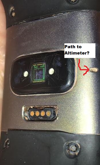

My question: Is the pathway to the Altimeter around the charging port, through the small oval or around the blinking light module?

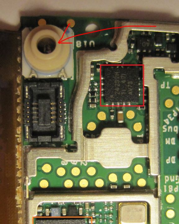

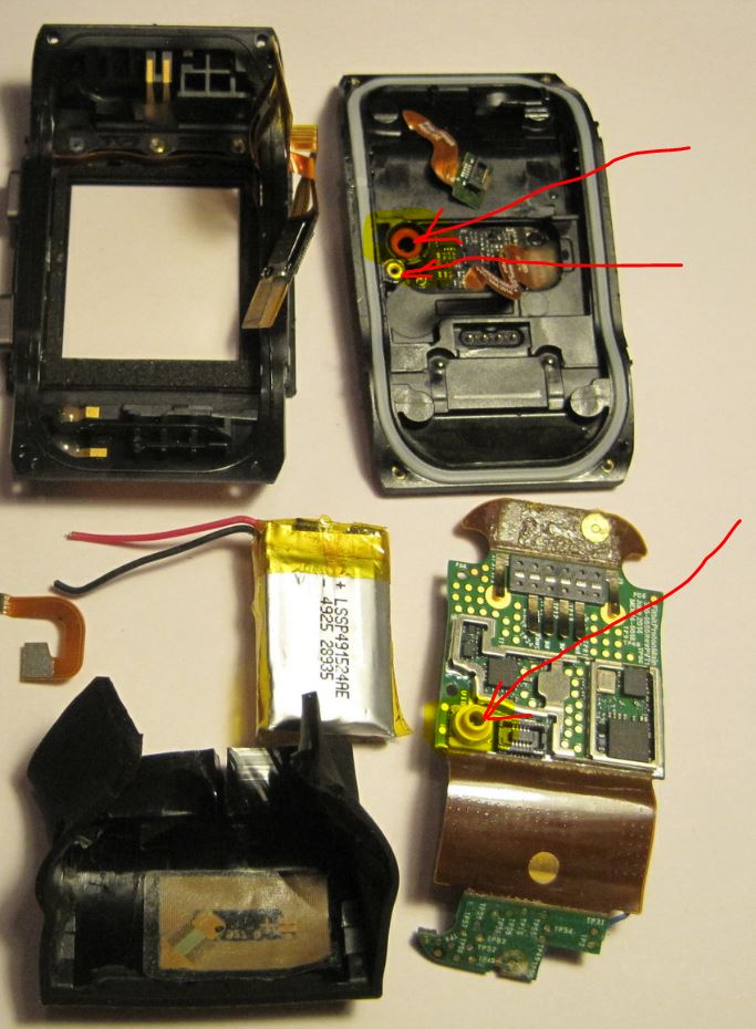

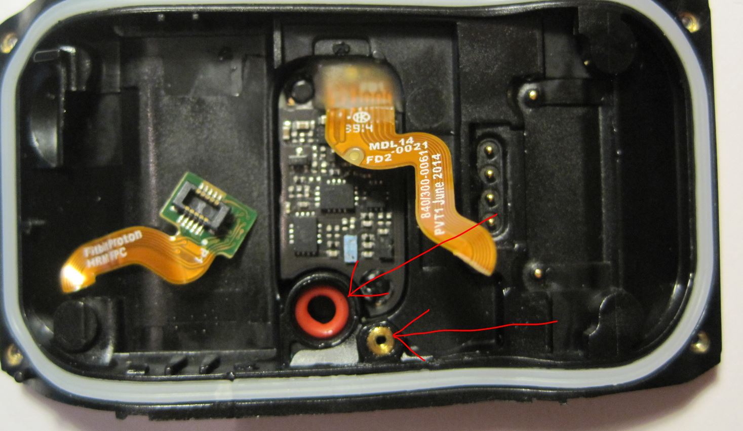

I found some pics of the insides of a Surge. I drew red arrows to suspected locations of the altimeter or pathways to the insides of the Surge.

that's correct

Thanks DuboisP!
Your link to the picture of the altimeter/pressure sensor solves that mystery...that's the altimeter.
I wonder how air gets to it...through the blinking light module or through the small port near the on/enter button?
99.9999% chance

Hello @spenceridge as @SunsetRunner confirmed from your first photo that is the pathway to the altimeter, sometimes it becomes temporarily blocked with sweat or water and this can cause inaccuracy on how the floors are recorded. Please note that your tracker may detect pressure changes unrelated to elevation gains, such as a gust of wind, weather change, or opening a door and credit you some extra floors. Also we recommend that your tracker be worn loosely during exercise, since a tight band restricts blood flow, potentially affecting the heart rate signal. That being said, the tracker should also be slightly tighter (snug but not constricting) during exercise than during all-day wear.
