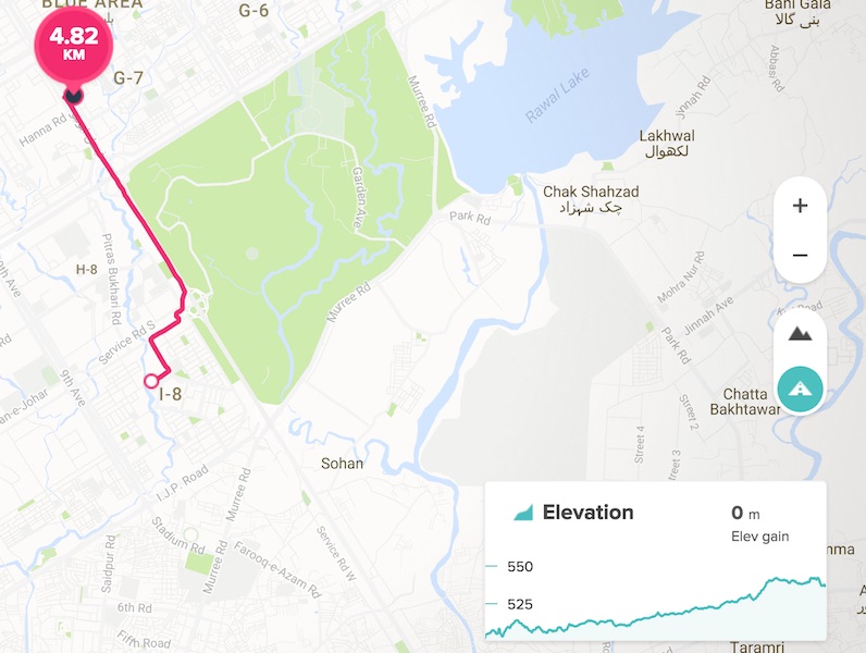

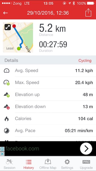

I am trying to wrap my head around the function of the GPS on the surge. I used it to track my bike rides yesterday. One problem taht I see is taht the elevation gain / loss is wonky. Road Bike app showed the elevation up as 48 meter and elevation down as 13 meter. FitBit showed zero meter elevation gain, but the graphic showed a constant climb, which is true (I was huffing and puffing). Photos attached below:

Please ignore the difference in distance, I had forgotten to press start on my FitBit. This question is about how to track elevation properly using FitBit.

Hello @ZafarSami, good to see you around. The elevation is read by the GPS feature of your Surge, so this is independent on how your tracker read your floors.
So saying this, if the issue persist I recommend to restart your tracker, since by looking at your screenshots, indeed it look weird it doesn't not show any elevation gain on your exercise.
