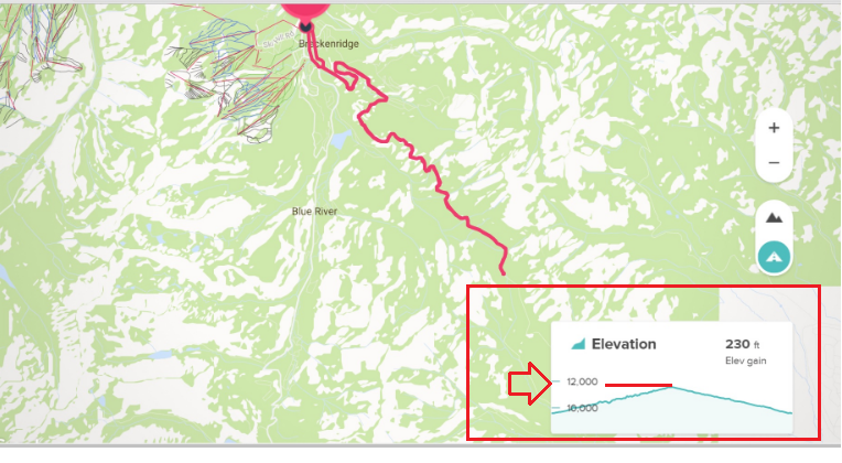

I just came back from Colorado and spotted a Surge anomaly that I don't understand.
On Wednesday, I rented a mountain bike in Breckenridge and pedaled up to the top of Boreas Pass. The bike rental place is at roughly 9,544 feet. The top of Boreas Pass is around 11,488 feet depending upon the source. My surge reported an elevation gain of only 230 feet. However, the elevation chart appeared to display the correct elevation gain with me starting below 10,000 and rising toward the 12,000 mark.
On Thursday, I hiked up to the top of Ptarmigam Peak. My guide book shows the trail head at 9,090 feet and the peak at 12,498 feet. There's also a hill of a few hundred feet that must be hiked before ascending the mountain. Therefore, the total elevation gain to the top should be around 3600 to 3700 feet in my estimation. My surge ran out of power on the way down but it still reported an elevation gain of 3,330 feet which to me is in the ballpark of the "true" elevation.
My question is : Why did the surge calculate hiking elevation well but the cycling elevation poorly?

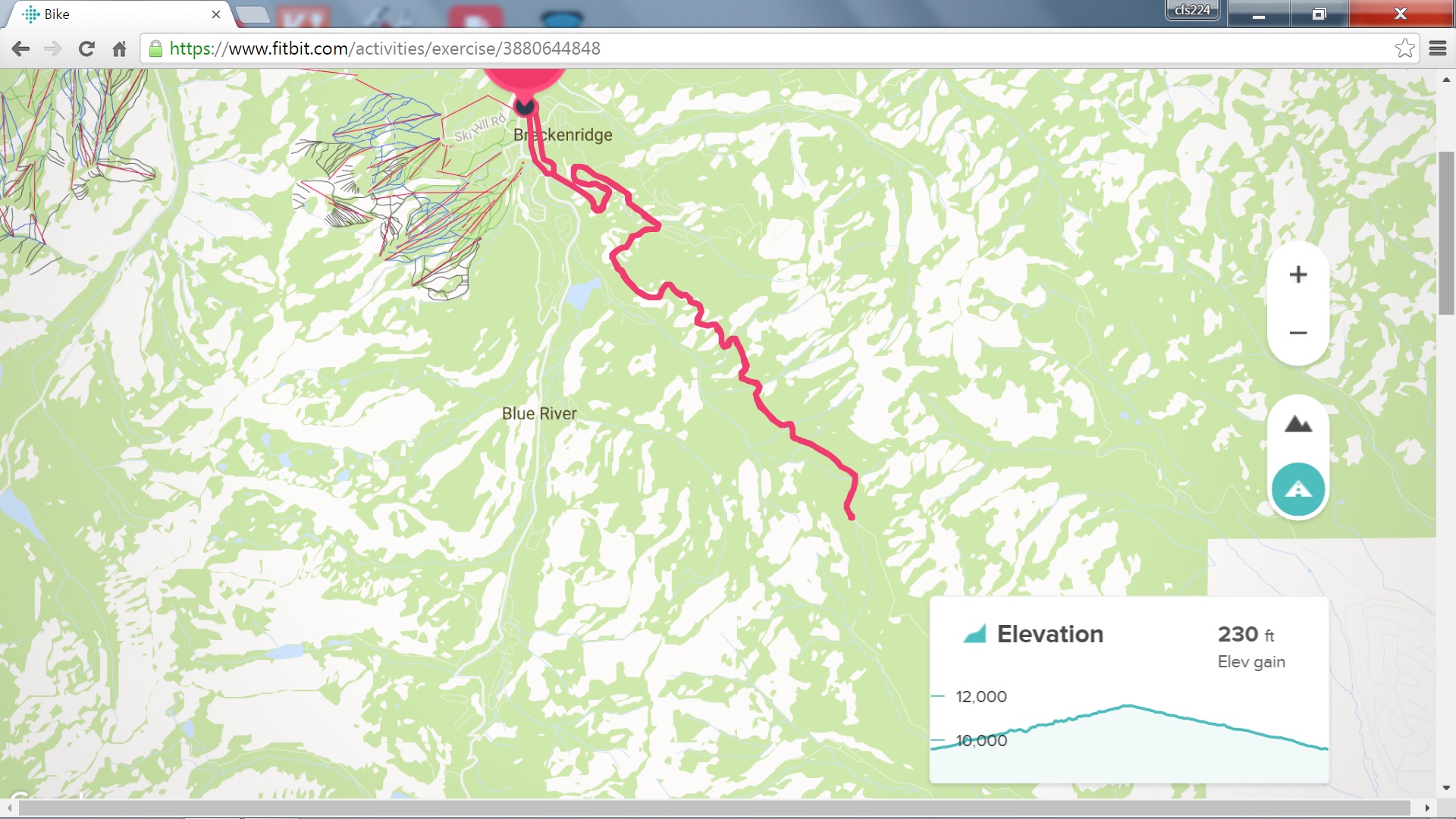

Roberto, But why is the elevation chart so different from the elevation gain value? Here is a screenshot from my bicycle ride. The graph sure does look like greater than a 230 foot gain.

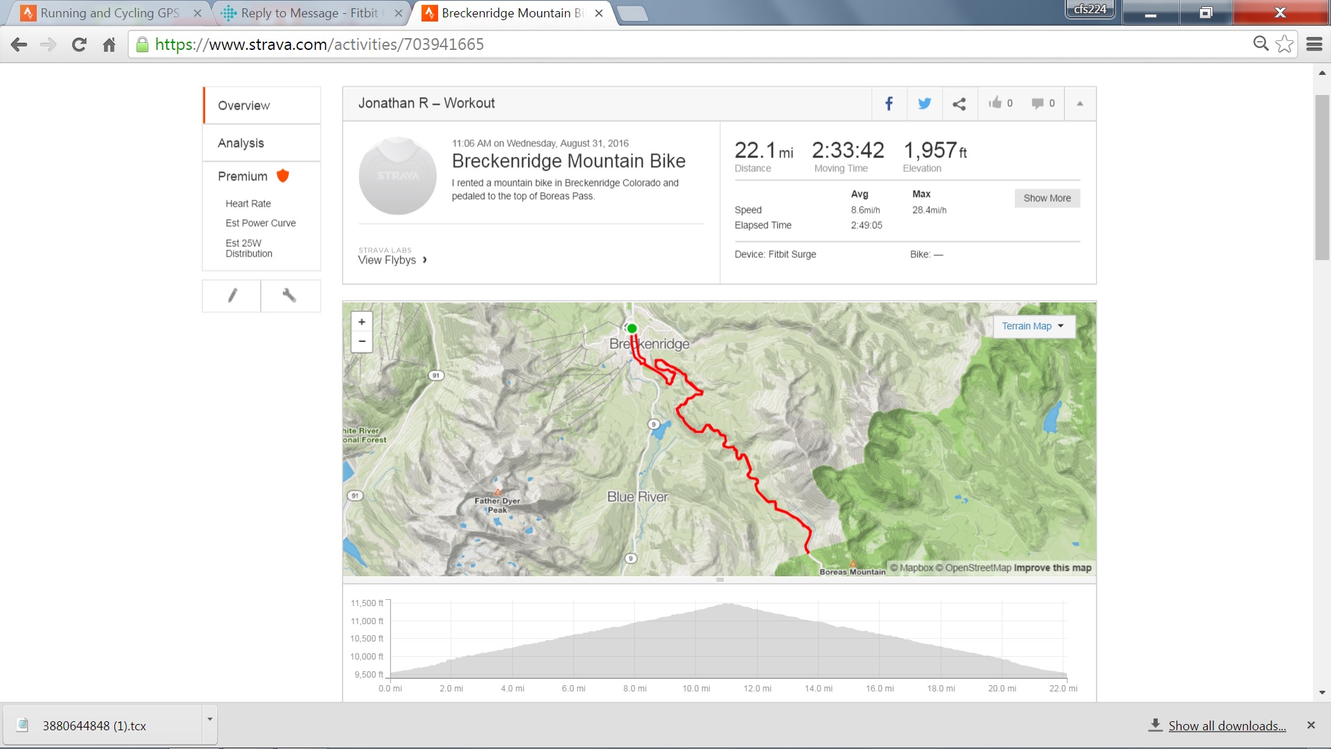

This is a follow-up post to a Hiking vs Cycling Elevation Calculation post I created.
I created a Strava account, exported the Fitbit Surge data to a tcx file, and then imported the Fitbit data into Strava. The profiles graphs for Fitbit and Strava both look similar. But, why does Fitbit show an elevation gain of 230 feet while Strava shows a correct elevation gain of 1,957 feet? Strava is using data from the Fitbit Surge.

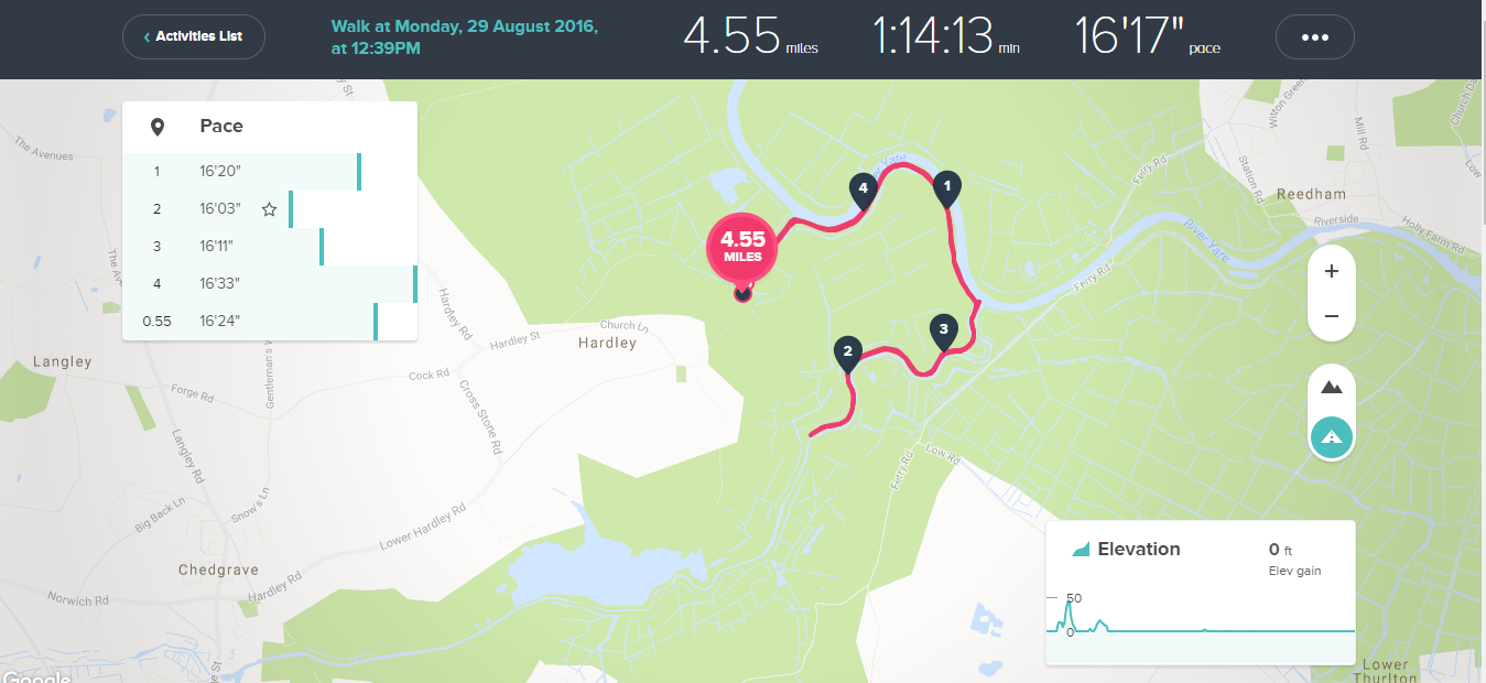

Here you go Roberto, this was a walk the other week, not much climb as I'm below sea level at some points in the Norfolk Broads but you can see a similar result to cyclingjon, a gain of more than 50ft at one point but 0 shown as gain....
