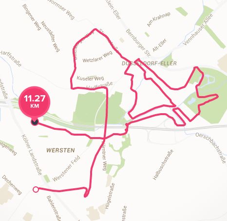

Hi everyone,
I've noticed fairly regular inaccuracies with my Surge's GPS.
Every few runs the GPS is obviously out, as in the picture below - it's a run which started and finished in the same place, but one would never believe it from the map. The GPS was completely out for the first 2km or so, despite waiting for a GPS lock before setting out. This seems to happen most often at the end of a run.
Do I have a buggy unit or is this a general problem that Surge users have? Is there anything I can do to fix it?
P.S. I very much enjoy using Fitbit's products and services!

Hi there @pedris, thank you for keep me posted how it goes this issue. Sometimes this have happened to me when I go for a short run. There is a radius of distance the GPS will pinpoint your location and sometimes wont reflect the actual course you have took it. To give you an example, it will show you were running across the street, but in reality you were running in straight line. However this shouldn't impact your final result specifically talking about distance, amount of steps and other stats. Although the actual accuracy depends on both your environment and the weather.
If you have tried already the restart I mentioned before, and the issue still persist. We have come to the point to approach our Support Team. So they can review your device history with you, just let them know all the steps we have reviewed here.
See you around and if you have more questions, you know where to find me. ![]()

Are there a lot of tall buildings or lots of heavy tree cover on the route mapped above?
I ask because this time of year here in New England is the worst from a GPS accuracy perspective; then there the issue of heavy cloud cover. I've noticed the accuracy of my Surge drop with a low cloud deck, and when combined with overhead foliage, my routes can by decidedly messed up.

It's possible, but unlikely I would hope.
The buildings aren't particularly high in my neighbourhood, nor is the area heavily wooded. I had similar issues in winter.
I haven't had any problems in my area with the GPS units on my HTC One M7, Samsung S6, or Moto G (3rd gen).

@pedris wrote:It's possible, but unlikely I would hope.
Ahhh, now I see where the disconnect is; unlike your Fitbit Surge which relies 100% on satellite reception for positioning, your various smart phones have positioning capabilities which include at least the first two of the following three methods:
Long story short, when the signal from the GPS satellites is obstructed, smart phones can still be quite accurate.

Hi @RobertoME. Thanks for the advice. My GPS was off woefully from start to (almost) finish on my run earlier today. No tall buildings or trees in sight. My Surge often seems to register my starting point incorrectly (by up to 500m), and then track the shape of my run reasonably accurately, before suddenly correcting to my actually position. I've restarted my watch - I hope this solves the problem.
It's all a bit frustrating. I'm trying to shave 11 seconds off a recent parkrun, and even a small discrepancy makes the data pretty useless.
Some tree cover in nearby parks. No tall buildings.

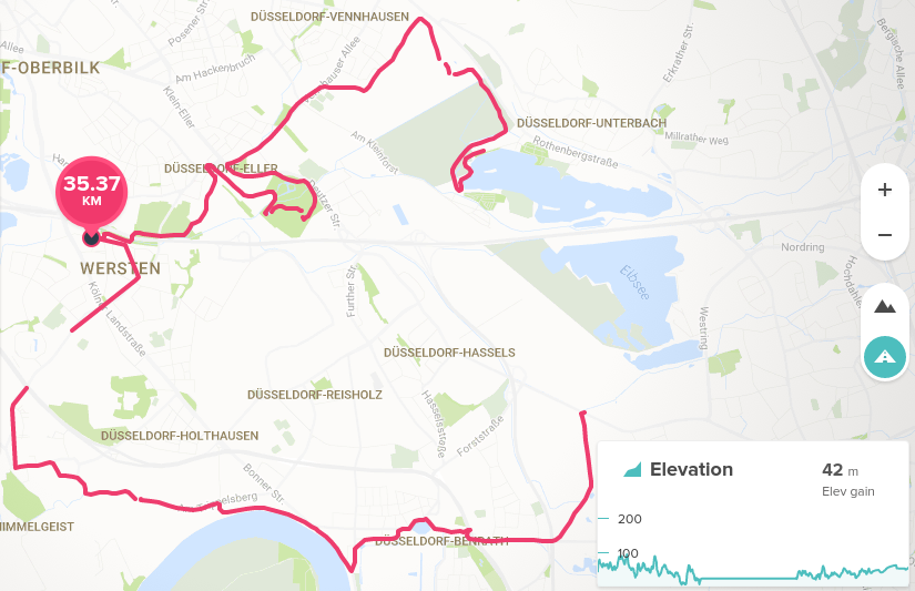

I went on a long run earlier today with my replacement Surge. Everything seemed to be working fine on the run (I was checking the tracker every now and then in order to stick to a consistent pace), but when I looked at the run on the Fitbit app it seems to have lost a lot of the route data, most notably between about the 11km and 22km marks. Fitbit gives lap times for all 35 kilometres. I'm not sure what the issue was - perhaps a GPS problem, software issue, or the tracker couldn't store 3h30min of detailed data?
It's been a beautifully clear day here and much of the route was unobstructed, so I doubt a poor GPS signal was to blame. Has anyone else experienced this problem and/or have any suggestions on how to avoid it happening again?
