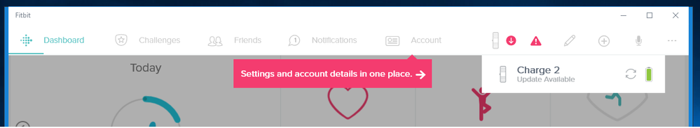

Thanks a million for your post updating the process of your Fitbit Surge. You're doing a fantastic job, thanks for taking the time and research those tips. I think that you're just a restart from your final destination. Fitbit Connect is very reliable when you're trying to update the firmware version, you can try to update one more time; don't forget to restart your Surge a couple times before to do so.
Then try to sync via Fitbit App to see if is is able to connect. You will find the arrows next to the battery level. Just click on them.
