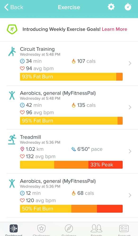

Hi @RobertoME,
This is an example of the duplicate entry I mentioned
Noticed that the starting time is the same
I wrote to MFP as well and after investigating, Runkeeper seems to be the culprit. After unlinking Runkeeper, all is back to normal. Ironically, Runkeeper have been linked to MFP for as long as I can remember with no similar problem. This problem only started recently.
