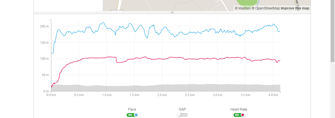

Has anyone experienced any issues with Fitbit and strava integration, especially uploading heart rate?
I am having problems with the heart rate data not syncing properly and its loosing a lot of data.
I record my activities with the fitbit app, now once this is stopped, it sends it straight over to the Strava app for syncing.
From my understanding it seems the file which is created via fitbit for strava gets stuck 3/4 of a way and keeps the same value of the previous number beforehand.
See here for an example. This is Strava's graph:
http://prntscr.com/9wys30
This is Fitbit:
http://prntscr.com/9wysmq
As you can see Fitbit does have the data but its not getting imported to strava properly.

I have tried exporting and this works fine. Below is the import data from fitbit, as you can see it has processed all data. This seems like more of a app issue.
Below is my latest run without any manual import. This is coming from my fitbit app to the strava app.
All my runs are like this.

Hey @HybridHayley, I think I know what might be happening.
I suspect it's related to what I've said over in this thread. If your Charge HR hasn't completely synced over its HR data before the MobileRun ends, it will likely end up looking like the chart you posted where it flat lines after a certain point.
I believe there's only a few options to remedy this:
1. Sync through another device/platform before ending MobileRun
2. Turn on "All-Day Sync" and wait for your Charge HR to sync before ending MobileRun
3. Export the activity and import into Strava
I know none of these are ideal solutions, but until the integration is improved, these seem to be the only options.
