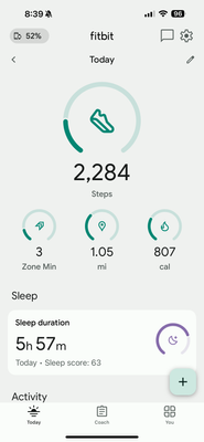

For further clarification: this isn’t just an issue with the Fitbit app communicating w the Lose It app, but with the Fitbit itself. The Fitbit and the Fitbit app are showing, as of this morning, 807 calories burned, when all I did was sleep, wake up, and do household chores for 30min. Never in ten years for tracking have I burned that much doing so little. More than two week and still no response from this company. 🤷🏻‍:male_sign:

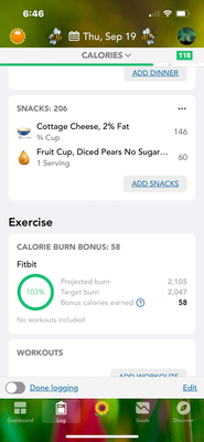

I didn't start today with a bonus, but I'm not sure that the communication is back to normal. I'm about 7% away from my "target burn" calories and I think that is a way smaller number than I should have - I think I should be at 50% or something! The day is only half over and I haven't exercised at all (office job).

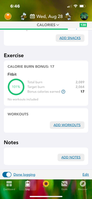

It’s better but not right. I used to have “total burn” and now I have “projected burn.”  At least I’m not waking up with an 800 calorie bonus but it’s still not right.
Mine has always been Projected Burn before the day is finished, the Total Burn after I've "Done Logging" and the day is officially over. I think it's fixed.
