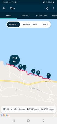

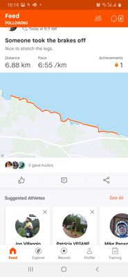

Same run, confusing data
The pic below is the same run. Knowing the route the 7.04km is about right. The split gives times for kms not completed and the strava data is derived from the fitbit.
Can anyone explain the variance?

Fitbit uses GPS to show the track on the map while calculates the distance with an algorithm that has at it's core the stride of your steps (in few words it measures the distance as steps x stride). When you export the session to Strava instead Strada takes the GPS file and adds some.proprietary algorithm to compensate (aggressively I would say) the GPS errors.
Hence the difference of the measured distance, splits and so on.

@SilviaFitbit  Now done a few runs but have the same problem.  This morning my regular 5k over a distance and course that has in the past been reliable.  Ionic 5.05kms Strava 4.95km.  This means I get no reliable 5km comparison.  Strava would normally give achievements  2nd fastest 5k etc but it cannot as it seems to think I have not done the 5k.  It would not be so bad if the Fitbit data gave you the stats that strava does but if I want to look at how it compares to other runs I have to do it manually.
I suspect that because I spent 6 weeks of lockdown running a twisty track round my garden using a shorter stride I have confused the stride length calculation?
@SilviaFitbit Anything?  Strava is the app that measures my PB/PRs and it is not doing it because there is an distance error
Edit:-  Gets more bizarre.  The strava app and the map show the same distance however there are 2 different distances within Fitbit.  4.97  and 5.05.  My target is 5km so once that comes up on the device display I stop however my distance is wrong on the map.
