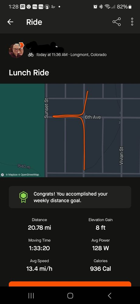

Well I though everything was fixed and then today it only recorded about 2 blocks of a 20 miles ride. Ugh I even continued to check that it was conected to the GPS on my phone and it showed it connected the entire ride.
Supposedly there is a new firmware out for my Charge 6 (210 and I am on 202) but nothing I do causes the update to show up. Unpair and Reconnect and reboot etc ... Somewhat frustrating. At least it is recording the mileage correctly I guess.
