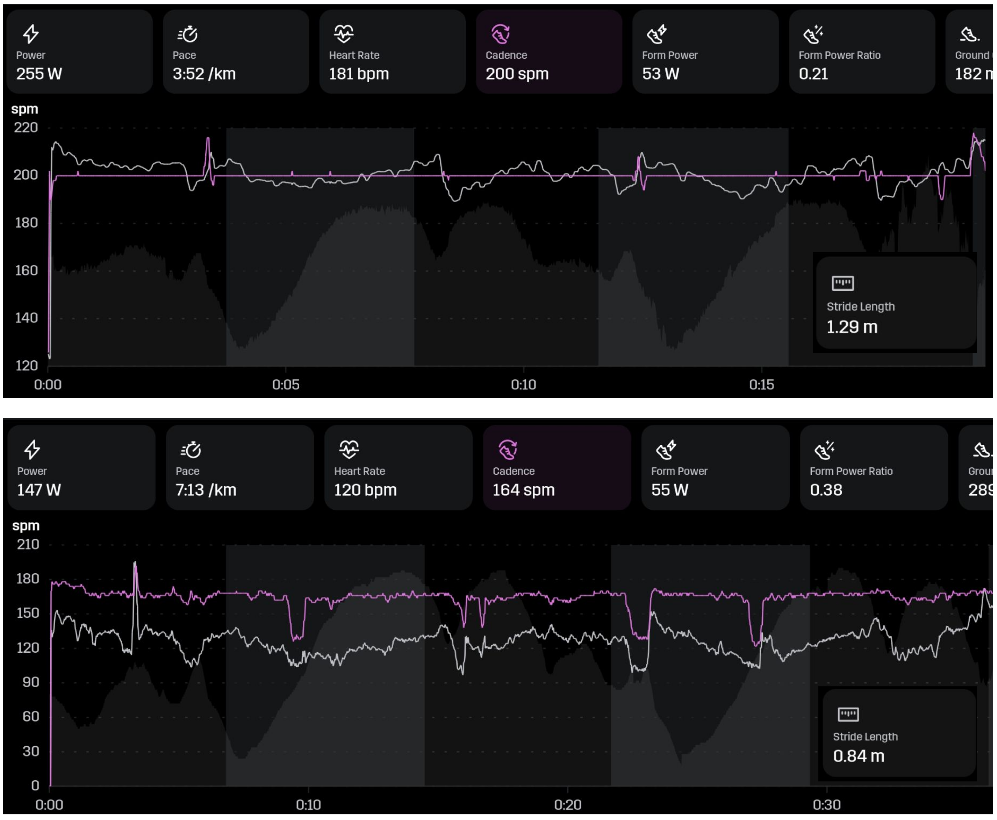

Below example. Same route (5K Parkrun race), with different intensities. Top: high and almost fixed cadence, racing pace, Bottom: variable and low cadence (ran it with my wife), jog/run (not a walk, though).
The white line represents stride length changing over time. It's not only that it's not constant but it's very different for both runs (1.29m and 0.84m). If you look at the elevation (the course is slightly hilly) you'll see stride length decreasing on inclines and increasing on declines. The pink line is cadence (steps per minute). Most amateur walkers/runners have an unsteady cadence (bottom chart), while trained runners have it almost constant regardless of elevation (top chart). Fitbit deals better with the first case so for me (I normally run like in the top chart) the distance is usually computed with a large error. A higher cadence isn't Fitbit's friend either. There is a larger error when I run 200spm (usual for trained runners) than 164spm (amateur runners).
This shows how many different factors the algorithm has to take into account in order to estimate distance closer to the real one. Saying Stride x Steps is just misleading because users try to calculate it by taking either walking or running stride and a number of steps and it never adds up.
