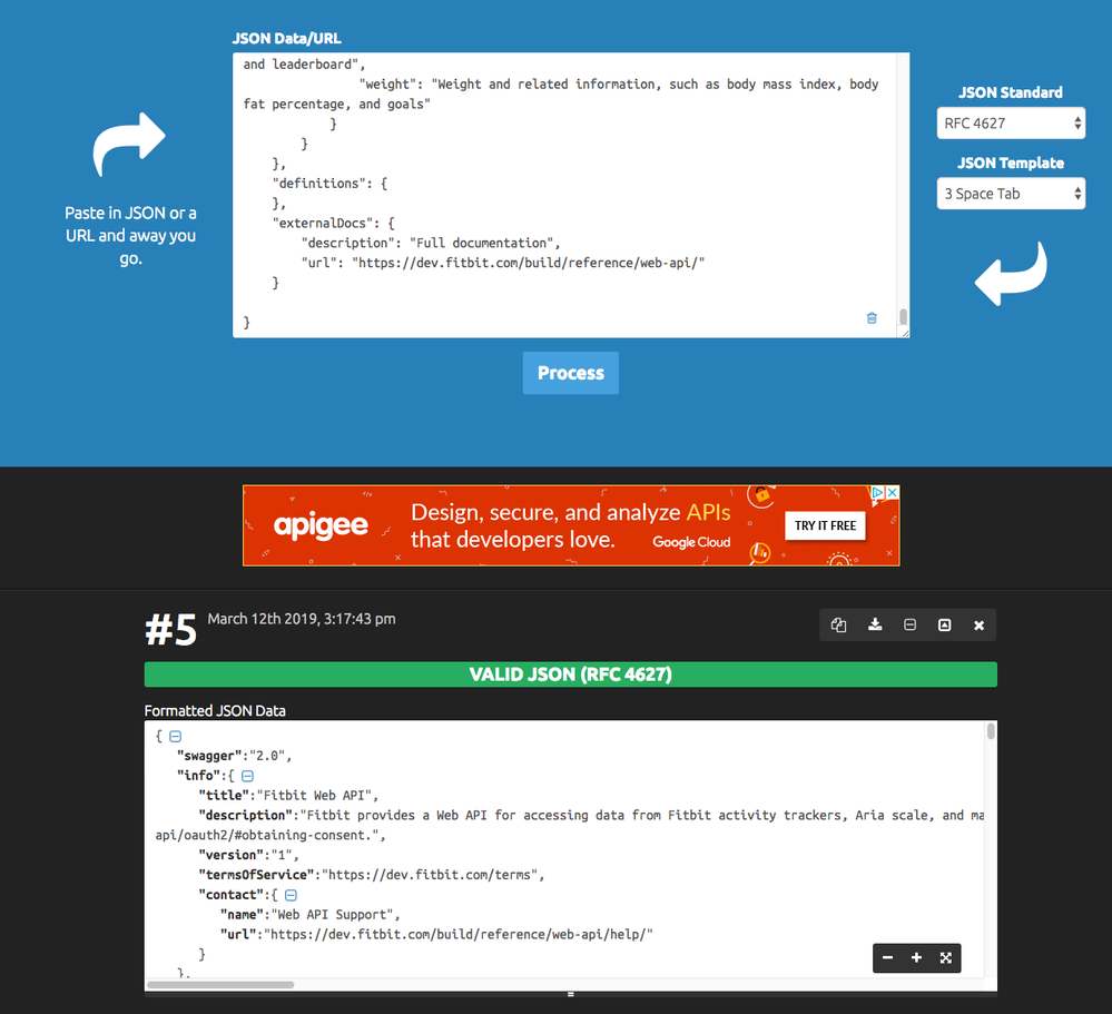

The WebAPI swagger document hosted here: https://dev.fitbit.com/reference/web-api/explore/fitbit-web-api.swagger.json
This JSON document is invalid JSON and thus is not valid Swagger document. Unfortunately this means I cannot generate client code from the Swagger JSON. One of the core benefits of Swagger is that I can take your Swagger file and generate a large bulk of the client interaction code using automated tools. As the Fitbit WebAPI is very large, I do not want to have to do this by hand!
Examples:
Results:
{"schemaValidationMessages":[{"level":"error","message":"Unable to read content. It may be invalid JSON or YAML"}]}
JSON Validator:
https://jsonformatter.curiousconcept.com

The JSON itself is invalid. I was having the same issue when I downloaded the JSON to a file and validated it. It is not the delivery method (HTTP vs. File) that is at fault; the JSON structure is invalid (e.g. there is a comma in the wrong place).
Because the JSON is an invalid structure, automated tools cannot process the JSON and cannot generate client code automatically. I could correct the invalid JSON and use tool to auto-generate client code that way, but I found that correcting the JSON opened up further issues i.e. the Swagger document itself is invalid (e.g. duplicate operationIds, invalid types such as Date), so I would have to correct large amounts of the Swagger document.
I'll try to look into it further this weekend and provide a "fixed" Swagger file if I can, however I can see that your Swagger file is auto-generated by a tool for your service so anything I provide will still need to be implemented correctly server-side.

Hi Gordon,
Revisiting this issue I found that there still exists issues with the JSON structure (invalid) and Swagger document itself:
Paste the following URL into the text area and press "Process"
Error:Invalid encoding, expecting UTF-8, UTF-16 or UTF-32.[Code 29, Structure 0]
Error:Invalid comma, expecting }.[Code 141, Structure 572]
Error:Expecting string, not }.[Code 8, Structure 573]
It doesn't look like I can generate client code from the Swagger document still.

Fitbit Developers oversee the SDK and API forums. We're here to answer questions about Fitbit developer tools, assist with projects, and make sure your voice is heard by the development team.
03-12-2019 15:22
Hi @BenDavies,
When I process the JSON URL, I do receive the "Invalid encoding" error message.
However, if I cut/paste the actual json into the field, the json validator states the json is valid. Do you see the same?
