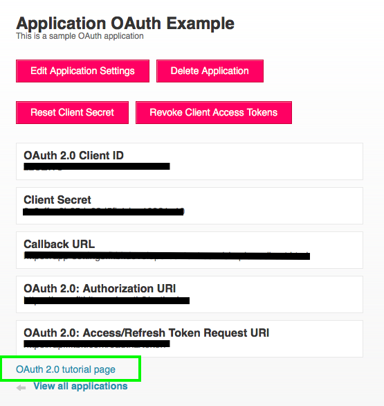

Hi @hsalbi. What programming language is your application written with?
Have you tried the OAuth 2.0 Tutorial to determine if you can successfully connect? This will remove your application from the environment and confirm if the problem is with the Fitbit service or your application communicating with Fitbit.
The OAuth 2.0 Tutorial can be found here. Or you can access it from dev.fitbit.com within your application's configuration. We will fill in parameters automatically based on the information in your application's settings.
