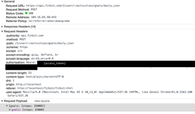

First, in my original attempt, I was trying to POST data using the "body" parameter. This is what has been recommended elsewhere on StackOverflow for POST requests. Applied to Fitbit, if the JSON was well-formed, the POST request succeeded. There was no error generated, simply nothing updated. (see image for detailed parameters)

However, the Fitbit API apparently only takes *parameters* to a POST request, not data sent as the body of a request. (in cURL, this is represented as "--data". In Fetch, this means actually manually appending data to the URL: https://github.com/github/fetch/issues/256)
So, to solve this problem I changed the actual URL (see below):
