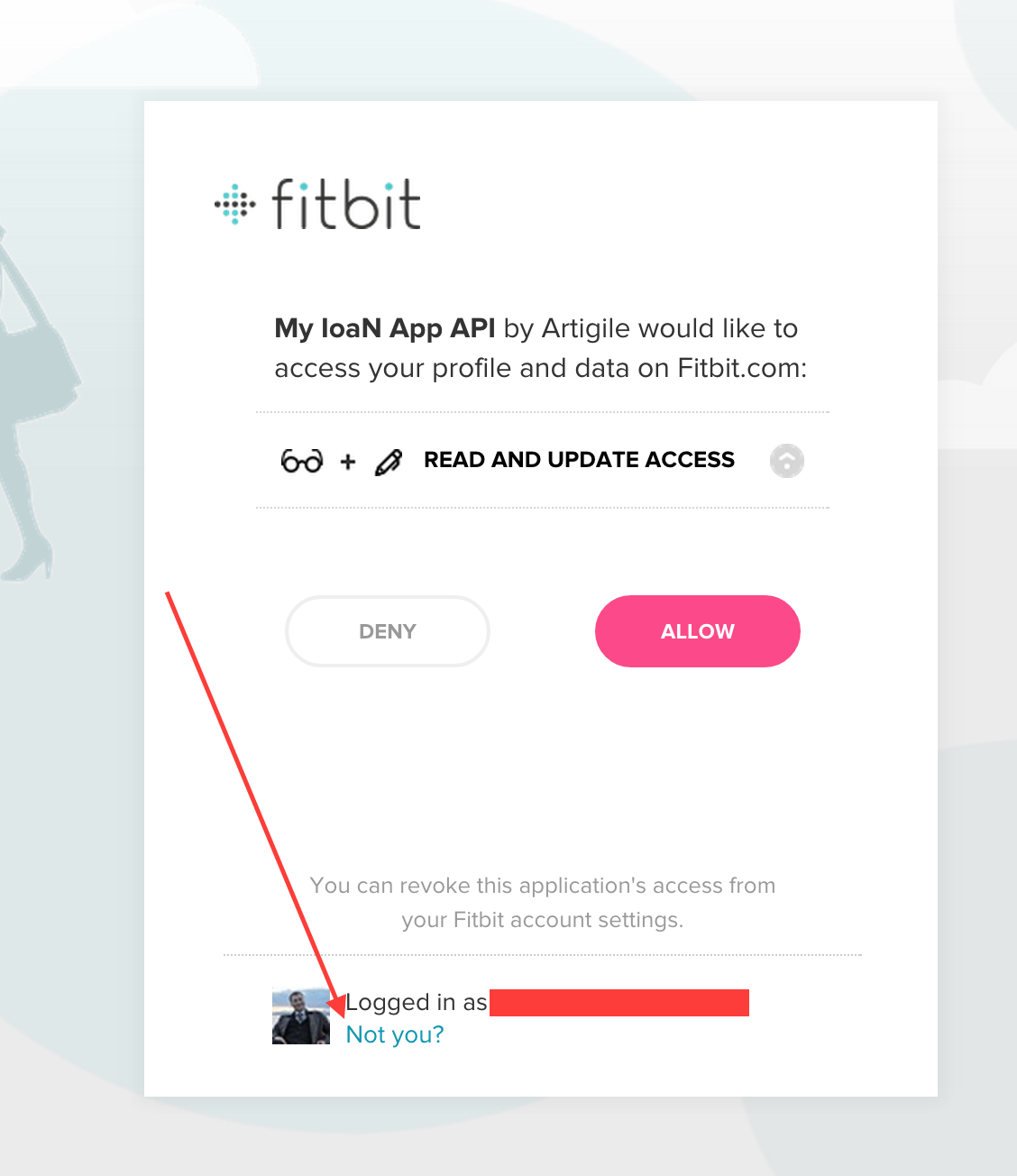

to be clear this is the screen they are seeing. they are NOT noticing the "not you" link. what i would like is to show the user id/password prompt instead of just showing the allow/deny buttons. or if i could forceably logout whomever is logged in on  a computer that would be fine too.
