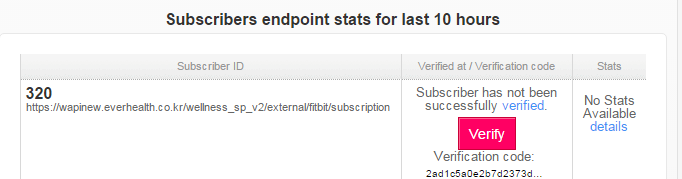

We do see the 2 requests in the IIS logs, but the endpoint is still not being verified. We use a proxy server and redirect to the server we want.
Both are GET request and one is a 204 and the other is a 404. The verification code for the 204 matches up with what is on the FitBit site.

Did you ever resolve this? I'm experiencing the same:
the endpoint is getting called with the ?verify=... parameter value. I send 402 for the wrong one, 202 for the right one but it still doesn't work.
So:
- url is being called correctly
- the verify parameter is coming in nice
- the wrong one is answered with 402 correct
- the right one is answered with 202 correct
- this all happens well within 3 seconds
The subscriber still isn't being validated. Any thoughts?
I'm running the project locally in Visual Studio and I am using ngrok to make it reachable from outside the network. I see the calls being received and my logging shows I'm reacting right so I'm getting clueless right now..
Thanks in advance,
Edwin

Hi @eekayonline. Instead of responding with a 202 and 402, try 204 and 404.
https://dev.fitbit.com/build/reference/web-api/subscriptions/#verify-a-subscriber

Thanks for getting back at me.. the 202 402 were a typo (thankfully).
But I managed to get this going...
As it appears my function - written in C# for a .net Core API - that receives the ?verify=xxx parameter returned a HttpActionResult for which I'd set the status code to 404 or 204. The HTTP response was 200 OK which isn't as specified.
I changed the function result into an IActionResult and returned NotFound() and NoContent().. The result was then the right HTTP response.
I found this out using ngrok's web interface which showed me the 200 OK in big letters...
