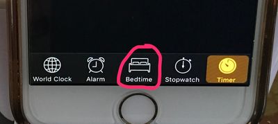

@Qonix - I just discovered that the iPhone has a feature that allows you to set reminders to go to sleep. This is separate from the Fitbit app. Please check to make sure the iPhone feature is off. To do this:
Best AnswerThe notification is still there.. Regarding the other solution it has nothing to do with fitbit, however I have it turned off by default
