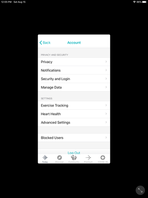

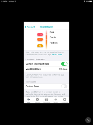

IpadOS 13.6, Fitbit 3.27
Enter custom max HR
Back out to previous screen
Go back into HR screen, custom HR gone
