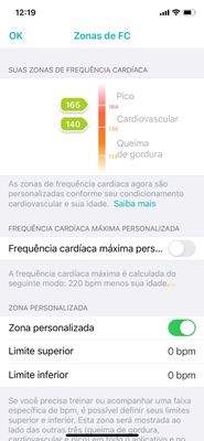

My custom max heart rate is going back to zero by itself, also custom min-max.
and then turns itself off.
tried restarting phone/Fitbit, logging out and deleting the app.
it is this way on another one too.
my max heart rate showing for a second and then go back to zero.. and then turns off.
Anyone know the problem?

I can’t edit personal heart rates either. They turn to zero the moment I edit.
Same problem, no solution 🥺

For Versa 2 there was a device update this week. Before that (last week), I updated the app on 2 iPhones, and did a favorite reset one two devices. I was then able to modify “max”, and “heart ranges” on the web (my Accts on www.fitbit.com dashboard) and those personal edits would push down to the iPhone app AND STICK! If I tried to edit on the phone, same problem, so I stayed with making changes on my dashboard on the computer..... Late this week there was an OS Update available to the Versa2 device itself. Problem remains with trying to edit heart rates on the iPhone; still must be done on the computer web app dashboard. Remember, after you edit on the computer dashboard that you can go into you phone and VIEW ONLY, to see if your personal changes were pushed down to your phone...
