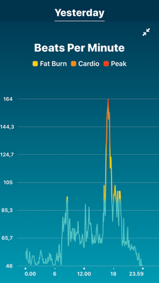

Every day my sport log shows the max heart rate of my daily exercise as around 168 to 178, but when I go to the ”heart rate” panel and see the diagram for the entire day, the same max heart rate is 20 lower. Is there a reason for this or have I personalized my settings wrong?

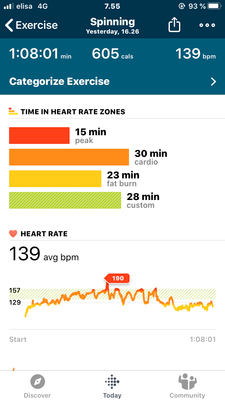

Thank you, I mean the attached. I have had the custom maximum heartrate between 180-190 but it does not seem to have an impact. For instance yesterday, max during exercise was 190, but when I look at ”heart rate yesterday” it shows a max of 162. Why are these different?
@TeeaK   The reason these numbers are different are that your heart rate is recorded every minute in the exercise details (both when you use the exercise app and SmartTrack), but it is a five minute average in the daily heart rate graph.
