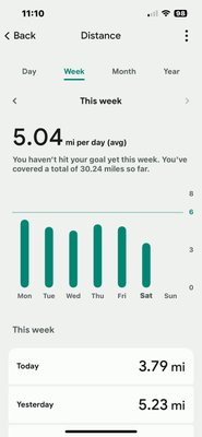

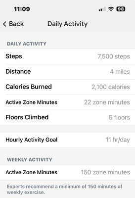

I have my daily mileage goal set at 4 miles per day in my activity settings, but it is always set at 6 miles per day in the app ( see screen shots). This has been going on for several months. Consequently I never meet my daily step goal even though my daily average for the year is over 5 miles.
I have an iPhone 13 currently running iOS 17, using a Versa 3 and/or a Sense, Fitbit OS 4.0.1 but the problem started with version 3.9. Any way to fix this? Thank you.

@Rge It is a weird miles to kilometers bug that is new to the iOS app. Android users have had a bug for some time, but I don't know the specifics of their bug. My distance goal is 5 miles. When I look your lower level screenshot on my app, my goal bar is at 8, because 5 mi = 8.05 km. In your case, 4 mi = 6.43 km. My main dashboard page is correct and the circle closes at 5 mi. My Sense 2 Today stats gets it wrong. It says my goal is 8.05 mi.
