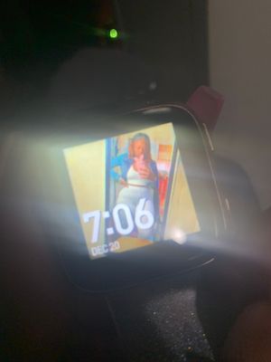

As I recently stated my Fitbit Versa basically stopped working, wont sync to my iPhone anymore, the date is seven days behind, time is wrong and the it won’t stay charged (goes from 85% - 0% within 2 hours). I did EVERYTHING that was stated to make everything work again, restarted my phone as well as the watch MULTIPLE times, uninstalled and updated the app, turned my Bluetooth off on my phone, EVERYTHING. I call Fitbit Customer Service, she tries to instruct me to do all of the same things that I told her I had already had done multiple times, she pauses and says “Well I can give you 25% off a new watch”, I then ask her so are you telling me the watch I have here is basically garbage and there is NOTHING I can do to fix my watch ? she then says “You can sync the watch to a different phone or tablet”. I am DISGUSTED with Fitbit right now, I spent my money to buy this obviously unfixable product and customer service has NO REMORSE and clearly can’t help me.
