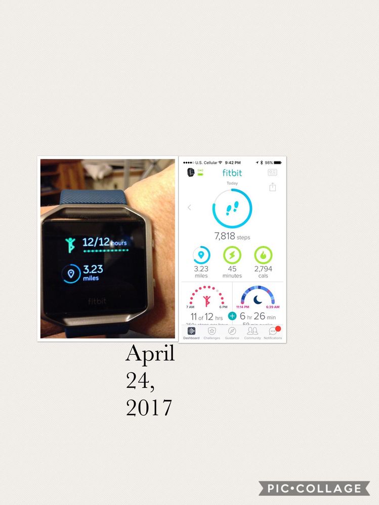

For the first time ever I'm having a mismatch of information. My Fitbit charge 2 shows 5/10 hourly completions and my app shows 6/10?! Granted at 11:58 I started running like a mad man to hit my goal... let me know if you want photos.

Same issue here, repeatedly. Lost two hours today that I know I hit over 250 steps and my charge2 recognises that, but not the app...

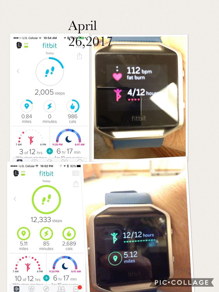

Another day, another disappointment. I know it's just a green electronic star, but darn it when I realized at 10AM my sync was already off it's frustrating

@Jksneddon - did you happen to update your iOS app to v 2.35 which was released yesterday (4/25)? Just curious if the bug still occurred for you even after the latest update. My app happened to sync all my hours correctly today after I updated, but it could just be the coincidental random nature of this bug.
