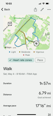

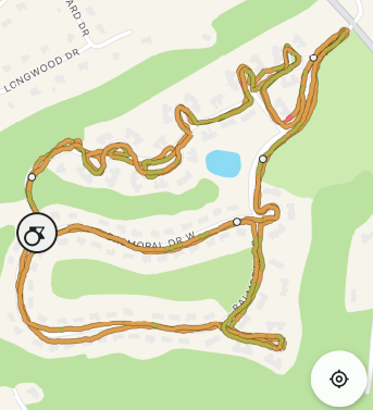

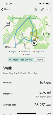

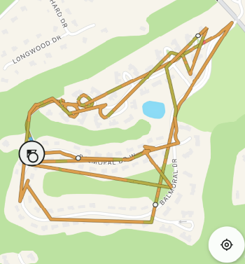

I wanted to bring up an issue I've been experiencing with the Fitbit iOS app recently, and I'm hoping someone here might have some insight or solutions.
It seems that the app is not marking all GPS points accurately during my activities, and at times, it's even skipping waypoints altogether (drawing lines over none pathways etc). This has made it impossible for me to trace and record my data accurately, which is incredibly frustrating as I rely on this information to track my progress and performance. mi pretty stable in my routes so I know what the data output should be.
I'm not sure if this is a widespread issue or if it's just affecting a few users like myself, but if anyone else has encountered similar problems or has any suggestions on how to fix it, I would greatly appreciate your input.
I've tried restarting my phone and reinstalling the app, disable/enable the location permission but unfortunately, the issue persists. If there are any troubleshooting steps I haven't tried yet, please let me know.

Having to keep the app active is impractical for any vigorous or long duration activity. I lose at least 25% of distance is the app vs Sense tracking. This is the same activity:
Sense 4.05 mi
App 2.95 mi
